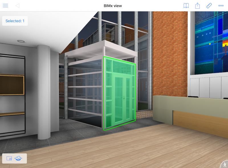

Get the complete link from BIMx
When a model is published to BIMx, the above link is automatically generated for each 3D element in the project. This link can be obtained by selecting the element in the 3D view of the BIMx project. You can choose the Copy Hyperlink option from the Selected elements settings. The Hyperlink is now copied to the device's clipboard:
The copied hyperlinks work the same way on both iOS and Android. Hyperlinks can be generated in BIMx Web Viewer too (see Help), however there is no transition between browser and mobile apps.
How to use the hyperlink
Open BIMx from external applications
If you launch this link from any application on your mobile device (Mail, browser, etc.) then it will bring up the BIMx mobile app, open the requested Hyper-model, select the linked model element and zoom to it in 3D. This way you can access any 3D model element easily without navigating manually in the model.
