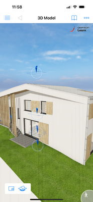

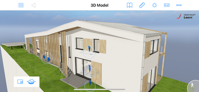

2023-09-24 12:26 PM
I've just update my iPhone and my iPad Pro to Version 17.0.1.
When using BIMx there are vertical grey areas (like shadows) in the 3D view.
These areas are not this visible when holding the iPhone in landscape mode (horizontal) and the iPad in portrait mode (vertical).
I've checked all possible settings in BIMx. With some settings it's getting even worse.
Is anyone facing the same issue or can help me out with some settings to solve this.

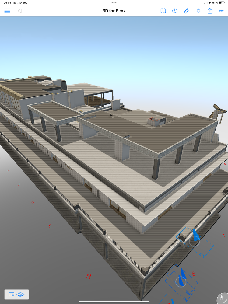

2023-09-30 03:00 AM - edited 2023-09-30 10:32 AM
Same issue on iPadOS 17.0.2…lines on shadows (or materials?)No issues on the same model on iOS 17.0.2

2023-09-30 01:38 PM
The fix works on most devices, but some 4+ years old hardware is still affected. We're on it and release an update as soon as possible. Thanks for the report.

2023-09-30 02:49 PM
The worst display is on black and white model display, so I guess it’s not the shadows but the materials (?). Anyway hope you can resolve this guys, as bimx is definitely an every day pro tool… Thanks for your reply Roland 🙂

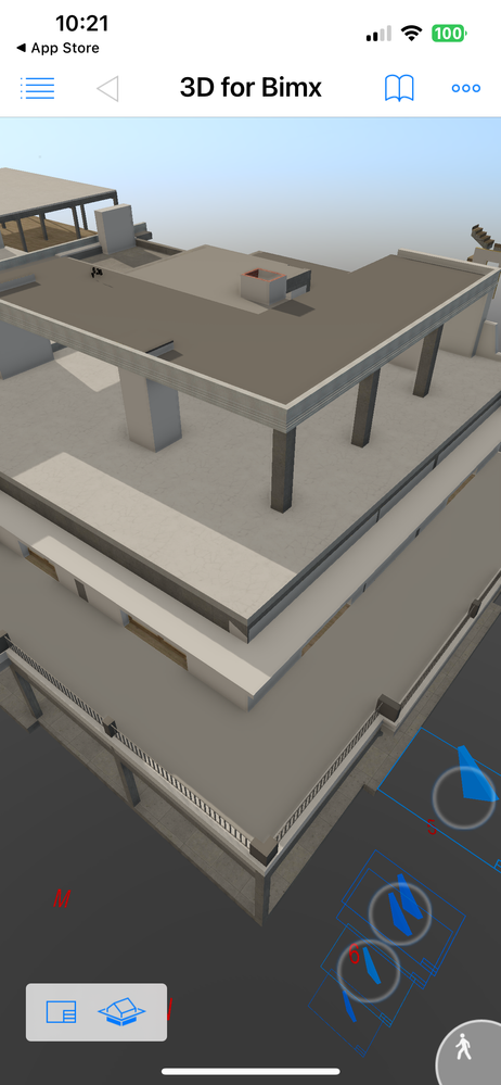

2023-10-09 11:59 PM
The latest bimx update fixed the problem! Thank you Roland
