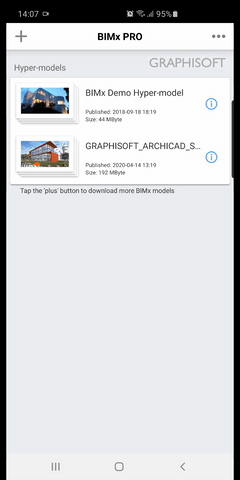

How to turn on logging in BIMx
  1. Open BIMx application on your device
  2. Click on the three dots on the top right corner of your screen
  3. Tap 3 times on BIMx version
  4. Enable "Support log"
  5. Try again to log in to BIMcloud or send a message to the affected user in BIMx: this will create the necessary log files

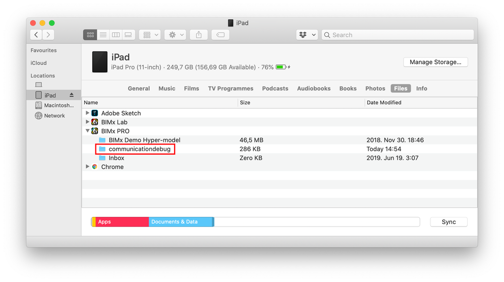

How to collect logs from an iOS device
After you enable the Support log in BIMx (see "How to turn on logging in BIMx", above), every connection-related activity between BIMx and BIMcloud will be stored on your iOS device.
If you re using macOS 15 Catalina or above the log files will be available in the Finder based on the Apple's description: Use the Finder to share files between your Mac and your iPhone, iPad and iPod touch
  1. Connect your iOS device to the computer, preferably with a cable
  2. Open the Finder and select your device
  3. Navigate to Files and select the BIMx App
  4. Save the "communicationdebug" folder by drag and drop:
NOTE: If you cannot see your iOS device in the Sidebar, showing the CDs, DVDs and iOS Devices might be needed in Finder Preferences:
On macOS 14 Mojave and older:
  1. Connect your iOS device to your computer, preferably with a cable
  2. Open the iTunes on your computer, the latest update if possible
  3. Click on the device's icon
  4. Navigate to File Sharing and select the BIMx App
  5. Save the "communicationdebug" folder
