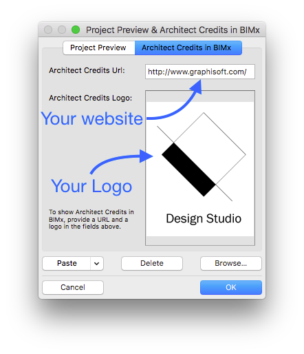

  • Go to File > Info > Project Preview & Architect Credits in BIMx and set up the Architects Credits.
    • Make sure the Architect Credits URL has a fully qualified name, it has to start with "http://" or "https://" (e.g. http://graphisoft.com) - Without this the URL will not be interactive in BIMx.
NOTE: You can use a PNG image with an alpha-channel background to make parts of the logo transparent

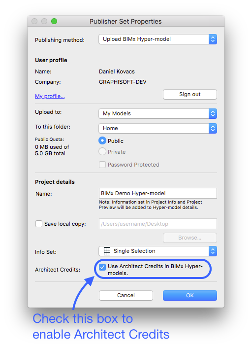

  • Open the BIMx Publisher Set Properties, at the bottom of the window, check the Use Architects Credits in BIMx Hyper-model box.
    • In case you haven't set up the Architect Credits before, this option will bring you to the new Project Preview & Architect Credits in BIMx window, from here you will also be able to add your company URL and Logo (as shown below).
