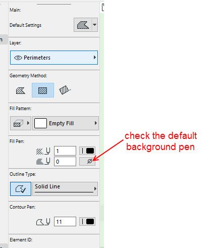

Last week all my schedules became greyed out when placed on my layouts.
The original schedule works fine, it updates normally, but they appear greyed out when I place them on my drawings.
I checked everything, they are displayed in high quality, I tried every pen set I have, every layer I can't get them to display correctly.
The thing is, they are working. If I decompose them on the drawing all the data is here, but hidden behind a grey hatch. If I delete the hatch my schedule appears normally.
This happens with every schedule I have, door windows, drawings list , I tried to recreate them but they still appear greyed out.
Anyone knows how to fix this ?
Thanks.

OK so I found a way to solve this.
When decomposing the schedule I noticed the background of the fill that covered it was the RGB wheel which doesn't correspond to any pen.
So I went back to the plan view selected the fill too and there too the default background pen what the RGB wheel.
I changed it to the transparent pen, went back to my drawings and updated the schedules and they reappeared.
It took me 3 days to figure this out... I hope this can be fixed for the next update or AC21.

I have this issue, but can't understand how to change background to schedule... Please help
If I understand this correctly it seems there is a bug where the default fill background pen affects the fill for schedules in layouts - why I don't know.
Go to your plan and look at the default setting for the fill background pen.
If it shows as a coloured wheel then this is the problem change it to a valid pen colour - probably the transparent pen (pen 0).
Then update the schedules on your layouts.
julienK
Yes thats it.
