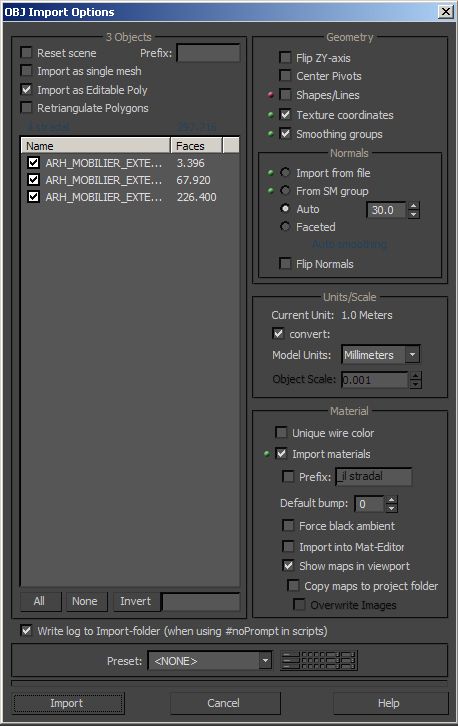

the best method I get for now, is to export the 3D model from Archicad as Wavefront object (.obj) and to to import it in 3dsmax. The model is imported as editable poly. You have to work a little to attach the poly's because they are split in two parts the smooth and the flat part but it worth because you get a much smoother result in case of curved objects and terrain mesh compared to the .3ds export, and you can further improve them in max.
If you have earlier version of max you can download an .obj importing plugin from http://www.maxplugins.de
If you have to change a part of the model you can delete that part in the max scene and to import again the modified one from AC, remap and render.
Have fun.
