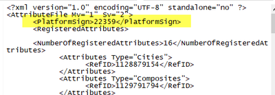

I create a master Attribute file whenever I make changes to my template. Then I can go into my project files and update their attributes to my standard. However, I have found that creating Attributes.xml file from the Attribute Manager on my M1 Max laptop, it will NOT load in into the Attributes Manager on my Intel iMac.

That seems really strange, since on your M1 Max, you're still running the identical Intel code (in Rosetta 2), so the format of the xml file should be identical.  Have you looked at the file with just TextEdit to see how it might differ from an xml created on your Intel Mac?   Maybe create a file with a single attribute on each platform and compare?   (I haven't shared attribute files since they were binary ".aat" files.)

But I am wondering does it work the other way - save on Intel Mac and import to M1?
Once you have the 2 XML files can you open them or preview them.
Are the first few lines the same or different?
I don't know much about the format of these files but I see the attribute XML files I have made have a 'PlatformSign' entry.
Other XML file created from Archicad don't seem to have this.
I have no idea if this is relevant or not - just wondering if the files are the same.
