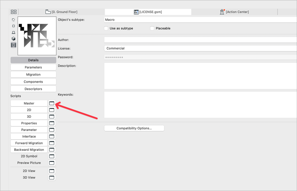

For any of those struggling with unlocking the 'LICENSE' file
Assuming that …
  • You have managed to extract the library (File > Libraries and Object > Extract a Container…)
  • Located the 'LICENSE' file in the folder called 'Macros'
  • Opened the LICENSE file, using the password neilsmith (File > Libraries and Objects > Open Object …)
  • Clicked to open the Master script
  • … you will then see lots of instances of "_licence", in various forms
  • You need to change the one at line 4 from _license=0 to _license=1
  • Close and save the 'LICENSE.gsm' file

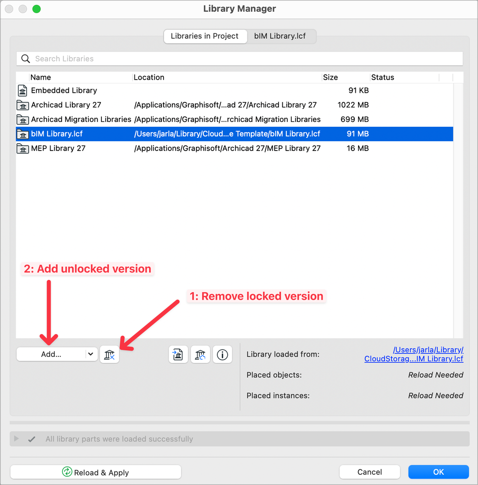

  • Repackage your now-unlocked library (File > Libraries and Objects > Create Container …)
    ( Like this: https://community.graphisoft.com/t5/Libraries-objects/How-to-create-a-Library-Container-File-LCF/ta-... )
  • If you still have the original library loaded, remove it
  • Then add the unlocked version of the library
