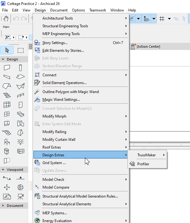

hey all i have spent a few hours trying to get the goodies accessories menus to appear but i still cant get access to them in archicad 22
i have tried uninstalling them and reinstalling goodies.
when i go to design - design extras - trusmaker is the only one to appear.
They are installed in the add on manager but they just dont appear
i can add them as objects but I can't do much else
i have tried to add them to my toolbar menu and it shows its there but its not.

You can try adding the missing commands with the Work Environment. Go to Work Environment > Command Layout Schemes > Menus, change the List to All Commands by Theme, look at 17 Add-Ons, the commands for the add-ons are here, you can then add them to your Work Environment.

We had the same issue in 21, possibly our solution might help you
The accessories.apx files for goodies was installed in c:\Program Files\Graphisoft\ARCHICAD 21\Add-Ons\Goodies however we were unable to see in design menu, nor were we able to add it to menus using the work environment.
We did manage to fix the problem by using the add-on manager, pressing add and navigating to the apx file and adding it manually. after a restart the accessories showed up.
I'm not sure whether there is some issue now that APX's are not added automatically, or perhaps it doesn't scan sub-folder. Hope this helps you.

I am having this issue with Archicad 26. Any information?
It is a know problem with 26 if you run Archicad before you install the goodies.
https://community.graphisoft.com/t5/Design-forum/Accessories-not-found-after-installation-in-AC26/m-...
Re-install (repair)m Archicad.
Do not run it.
Install the goodies.
Install the latest update for Archicad.
Now start it and all should be fine.

I have run into the problem that I do have any design extras other than TrussMaker and Profiler - I am looking for roof/slab and wall accessories. Are these part of Goodies or something else?
I have run into the problem that I do not have any Design Extras -
Yes, those are part of the Goodies which are a separate download/install.  If after installing the Goodies (with Archicad NOT running) - then when you launch Archicad if they do not show up in any of the places mentioned in this thread (Add On Manager being the place to look if not in the menus where they belong)... then you need to follow Barry's steps to re-install - which does indeed involve unininstalling Archicad, then re-installing, installing the Goodies, and then installing the most recent update to Archicad itself (which will update any add-ons, including the Goodies).

Actually, I found that you do not need to un-install Archicad first.
Just install again and you should get an option to 'repair' the installation.
It is just important that you do not start Archicad before you install the goodies, otherwise it removes the unused goodies commands from the menu.
And installing the goodies does not add the commands back (which you think it would).
