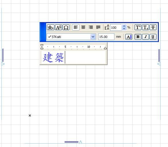

Kent wrote:
The Chinese texts are normal in Archicad, and corrupt while exporting in Autocad. Any help!

Finally I figure out how to solve the problem. I have to choose the CHINESE_BIG5 which is the right Text Encoding.
