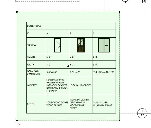

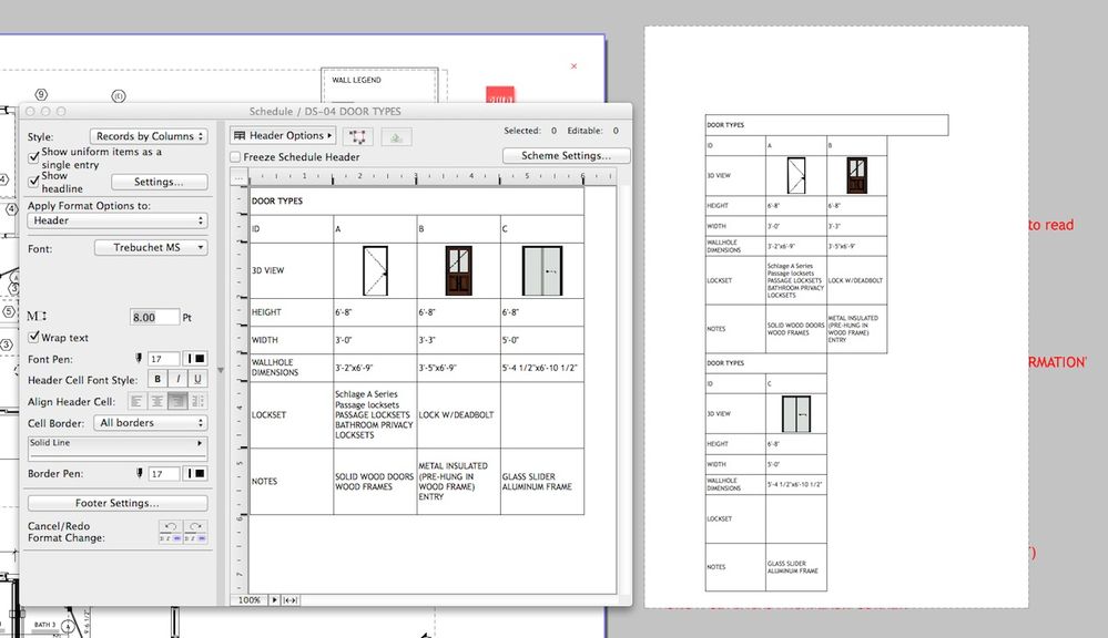

DOOR SCHEDULE ACTING WIERD SEE JPB BELOW
Here is the door schedule I created (on left) and how it shows up on my sheet (on right), how do I get it to show like the view on the left...what happened?

I FIGURED IT OUT! HAD THE "SHOW HEADLINE" CHECKED, WHEN I UNCHECKED IT, THE SCHEDULE RETURNED TO THE ORIGINAL RECTANGULAR SHAPE...SEE BELOW!
Perhaps the one on the left (a rectangle with the doors in a row) is different than the one on the right (a weird shape with two doors in a row and another door in its own row)...at least that is what my eye sees....
I want them in a rectangle with all doors in a row!
Use the 'restructure table' button on the pet pallette to reshape the schedule when it is placed on a layout.
See this thread for an explanation and picture - http://archicad-talk.graphisoft.com/viewtopic.php?p=146577
I'm sure it is to do with the calculation dimension settings (options > preferences) as I thought.
You may or may not have these set correctly but it seems it could also be your schedule view that could be using the wrong dimension style in its settings.
