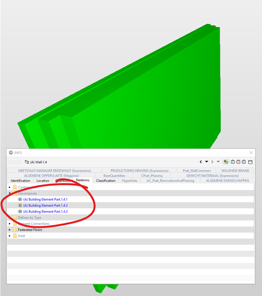

When exporting an IFC to use for Information Takeoff (Solibri) I would like to have all composites decomposed to their skins, preserving their materials and the ID of the composite they belong to.
I have tried several combinations with either BREP or not, but can't seem to produce what is needed.
When selecting a wall I should not get the whole component, consisting of 3 decompose (forward) elements, but I should have three seperate objects.
I know I can select them seperately (Shift-click) in Solibri, but I need them to actually be seperated, retaining the name information from its "parent" and the material from itself.

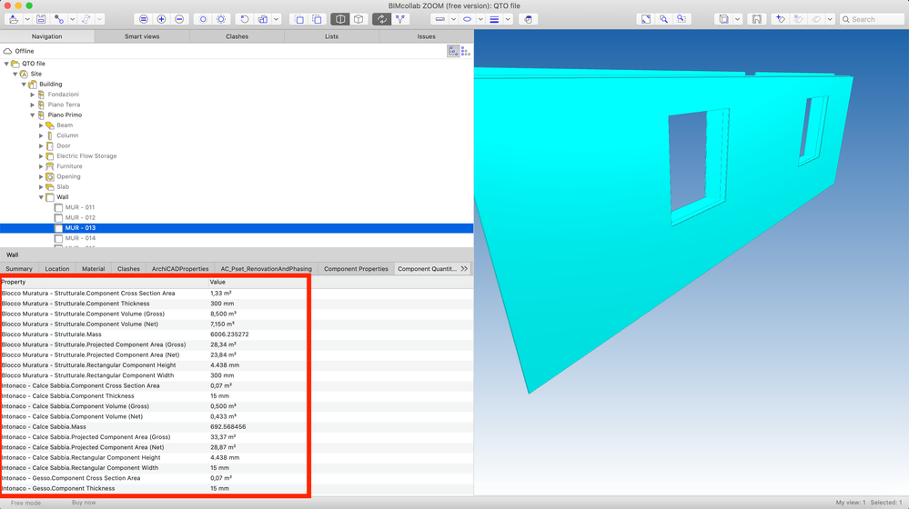

squall_tmo
Hi Johan,
I don't know if it's exactly what you were looking for, but from AC25 update 2 you can export the Wall with all the components information called with the name of the Building Material:
so we don't need to explode skin components anymore to understand the name of the Material and all the rest of the related info!
I hope this may help!

squall_tmo
I start from the question related to length:
I'm afraid but from what I know you can extract the height and the thickness of the component, but it's still not possible to extract its length (you cannot even in schedules).
In AC25 you can calculate the length "analytically" (out of Archicad obviously) because they added the "Gross Volume" and the "Gross Area" (obviously it's not exactly the same of a property printed out by AC...but it's better than nothing I suppose).
Talking about export settings I just set geometry conversion to never explode elements and in the Data Conversion I choose what I want to export, eg. Components Properties and Materials properties (I attached a couple of screenshot).
I hope this may be helpful!

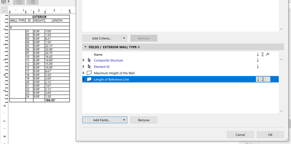

Steve Jepson
  "I'm afraid but from what I know you can extract the height and the thickness of the component, but it's still not possible to extract its length (you cannot even in schedules)."
But you can Schedule the Length of the Reverence lines and some other Wall Length fields - if that is any help.   I seem to remember using Length in 3D or something like that too.  ?
Johan Stinckens
Indeed @Steve Jepson , you can schedule the length of the reference line.
But the given length is identical for each of the skins as there is only one reference line for anyone composite/complex profile, regardless of how many skins it has.
And for this to work we need the length of each of the skins, taking into account that wherever skins touch/intersect, the common area of these components are calculated only once.
I just can't seem to grasp why an export to IFC has no length attribute included?!
Is this an anonimity in the IFC standard?
