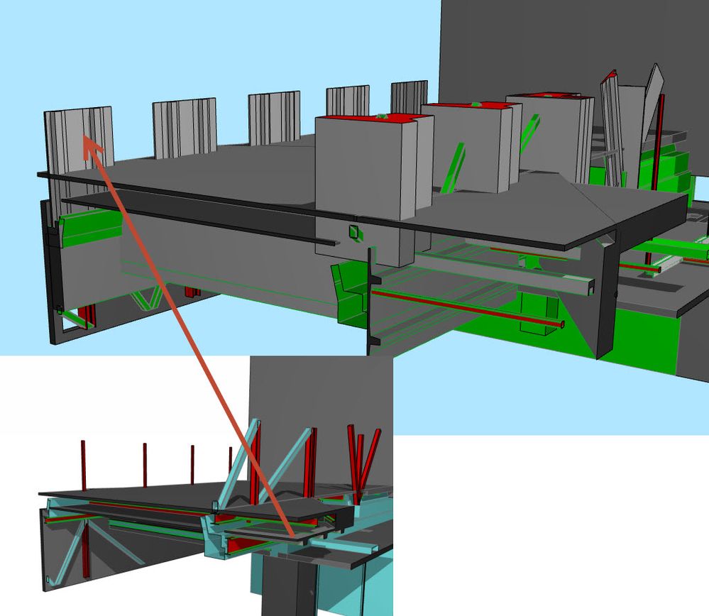

IFC elements rotates in module

from which program structure was exported?

That's rather troubling. I had trouble a couple years ago with structures imported from Revit doing similar rotations but that was in the initial import and it has not recurred since then.
Wait. I can think of a possible cause. If you already have the profiles existing in the file you are importing to the rotation angles may be different from the source files. I have seen this happen. Try importing to a clean file (hold option/alt to get "New and Reset" under File>Open). If this works properly you should be able to fix things by deleting the problem profiles. They should be replaced from the source on updating. If not you might need to reimport.
