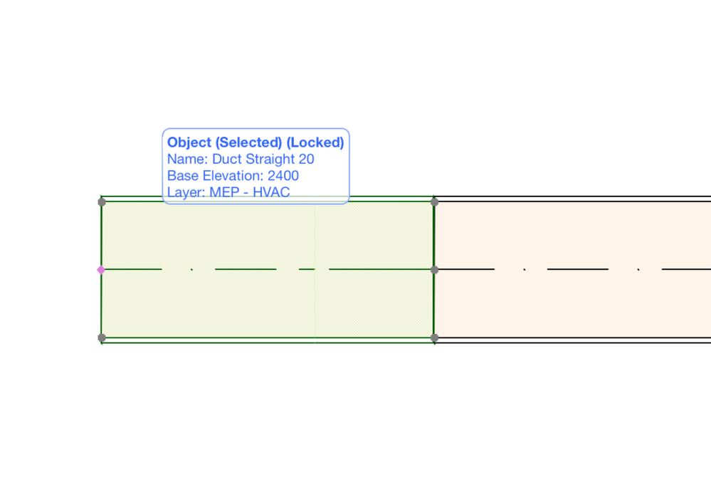

How do I edit MEP elements in Archicad without the add-on loaded?
If a project created in an MEP environment (add-on, MEP license and MEP Library loaded ) is reopened using Archicad only (without MEP Modeler but with the MEP Library loaded), the MEP objects are available, although locked for editing. If you wish to edit or move these elements, you must first unlock them individually (Edit > Locking > Unlock). Their MEP connection information is lost once you have edited them in a non-MEP Modeler environment and they behave as plain GDL objects in Archicad.

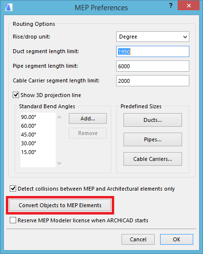

There are some objects in the MEP environment without connection parameters – how do I convert these?
It could be that some elements in a teamwork file, or elements pasted into a file with the MEP add-on from a file without the add-on loaded, will not be automatically converted. These can be converted using the “convert objects to MEP elements” button in the MEP Preferences. MEP Preferences is available at Design > MEP Modeling > MEP Preferences.

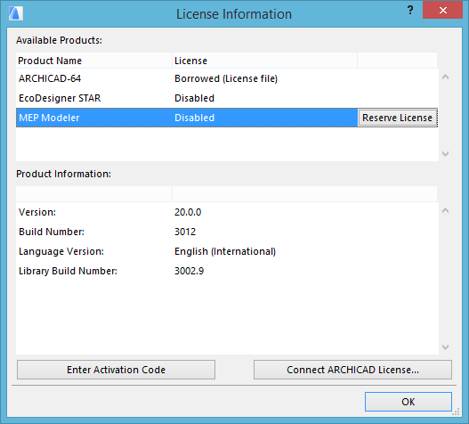

How do you control an MEP license on an Archicad network key?
There is an option in the MEP Preferences that will control whether MEP will be enabled. Check the option to reserve an MEP license automatically to start MEP Modeler whenever Archicad is opened, providing a license is available. This option is turned off by default.
If the option is not checked, MEP will not be enabled when Archicad is started, even if a licence is available. MEP related commands are active (with the exception of MEP Pet Palette items) for the user even if no MEP license has been reserved. If an MEP related command is used, the license will be automatically reserved if possible and work can be continued. If the license reservation is not successful, the command will not be executed. If Archicad is started without MEP, a licence can be reserved manually in the Licence Information dialog.

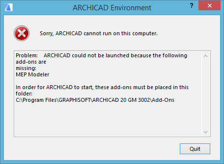

I have removed the MEP add-on - why do I now get an error message?
The MEP add-on is part of the basic installation and Archicad will not start without it. If MEP is no longer required on a computer, it should be uninstalled from the Control Panel, or by running uninstaller.exe in the Graphisoft\ARCHICAD #\Uninstall.MEP folder. If MEP is uninstalled in the recommended way, no error message appears when launching Archicad. (The MEP Modeler is part of the basic installation of Archicad. This means that installing MEP Modeler makes the MEP Template, the MEP Work Environment profile and the MEP Library available for Archicad. When uninstalling, the add-on stays in the add-ons folder, thus Archicad can still be launched, but the template, the Work Environment Profile and the Library will be removed. If you remove the whole MEP Modeler folder from the Add-Ons folder, the connection between Archicad and its add-on will be broken, that's why Archicad will not start.)
