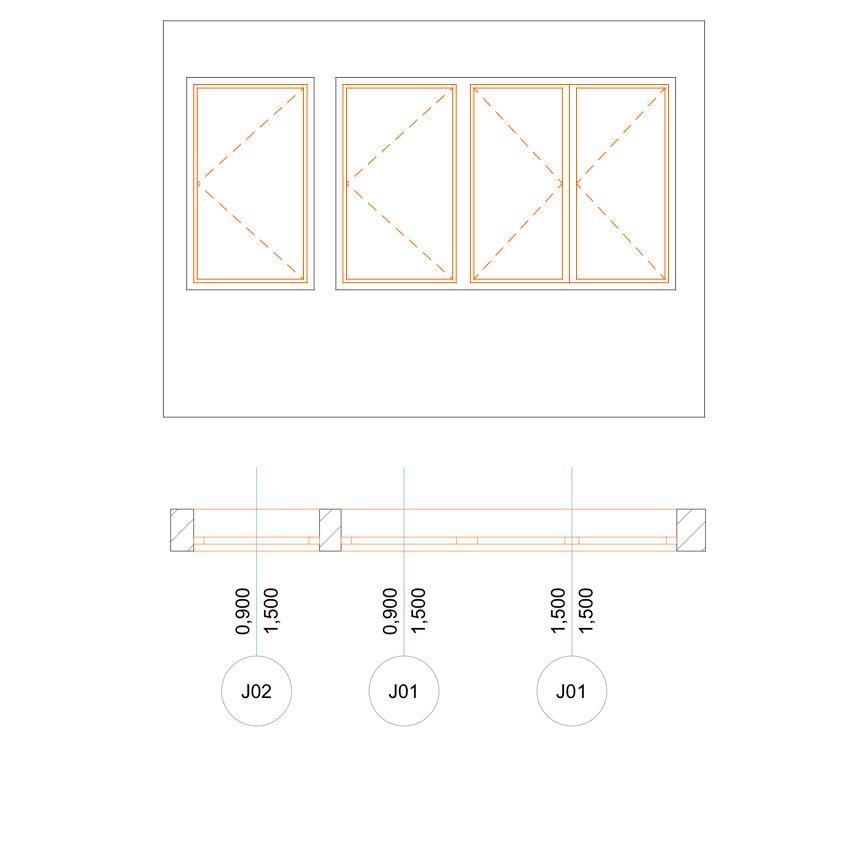

Hello everyone. I'm needing help here. Hope anyone can help. Sorry in advance for my not so perfect english.
I'm currently working in a building that the windows in the facade aren't simple. They are multiple archicad window. Below I show two images one facade and one plan. On the facade you can see they look like one window. on the plan they also look like one. But the ID show that they are two separate windows. And on schedules they are also separated. The problem is that my facade is in a metal structure and both windows have a single frame and in the schedule I need them to show like a single window.
Any idea on how to solve this.
Thanks in advance for all the help.

Hi uziproductions
You can tray use the curtain wall or create the own windows like gdl.
The problem with the curtain wall is the same. It doesn´t "tell" all the parts that compose the total window
One way to do that would be building a window from scratch, GDLless:
http://architruques.blogspot.com/2006/10/construir-uma-janela.html
Not so difficult as it looks.
