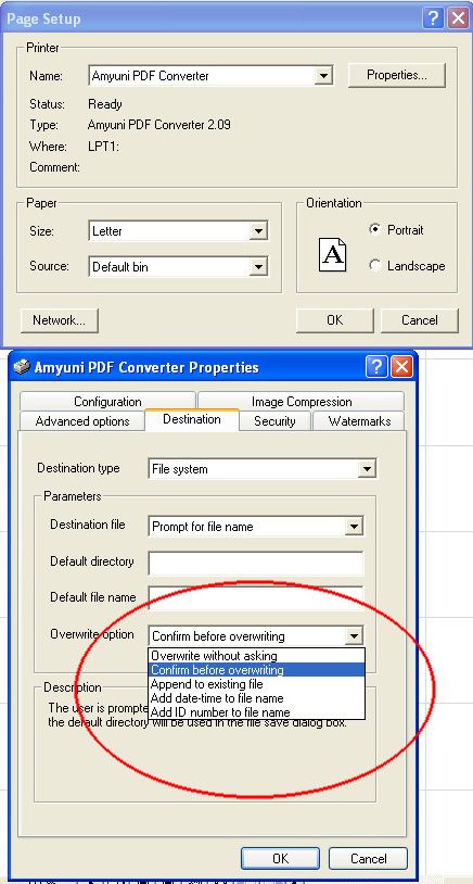

You can change the settings of your Amyuni PDF Converter Overwrite option to: "Confirm before overwriting" (it's under Destination tab in the properties) I think the default is "Overwrite without asking".
I'm on PC, I'm assuming it's the same with MAC
Where is it located? We get this on a Mac:

I just checked and you're right, you could only control this option, if you are "printing" to a PDF and not "saving" to a PDF in your publisher set, I thought it was there also.
On a side note, I find it better to create PDF sets by printing selected layouts to the Amyuni printer (not through publisher) this way you get all your layouts in one clean PDF file automatically organized with bookmarks, working links for the sections and details, etc.. as far as I know you can't do that with publisher..
Again I'm assuming all this is the same with MAC

I'm running Windows XP but it seems the same as your MAC problems.
Using the Publisher and Saving the PDF uses a default inbuilt PDF converter - "_temporary ArchiCAD10 publisher.
You can view the properties of this printer and you can change them but they don't all stick.
Seems you can change page size and margins but can't set to prompt for file name or prompt before overwriting - these will simply reset themselves to default values.
As Hassanen mentioned it is possible to Print from the File menu when in the layouts.
This way you can use whatever PDF converter you want and you can have its properties set as you wish.
The only way I have found to control the file name in Publisher (other than manually renaming the file) is to change the name of the parent folder that you set as the Merged folder for producing a single PDF.
