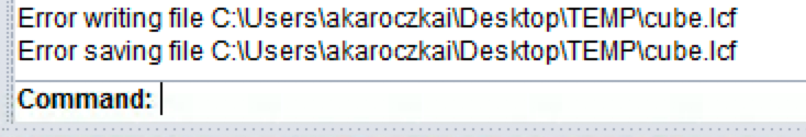

The Rhino LCF Observer does not update my Rhino imported model elements after reloading the ARCHICAD Libraries then Refreshing and Updating the elements in the LCF Observer. The issue is that Rhino cannot overwrite .gsm or .lcf files while they are in use by ARCHICAD since the file is locked.
The workaround for overwriting these files is to either close the ARCHICAD project or unload the Library which we would like to edit from Rhino.

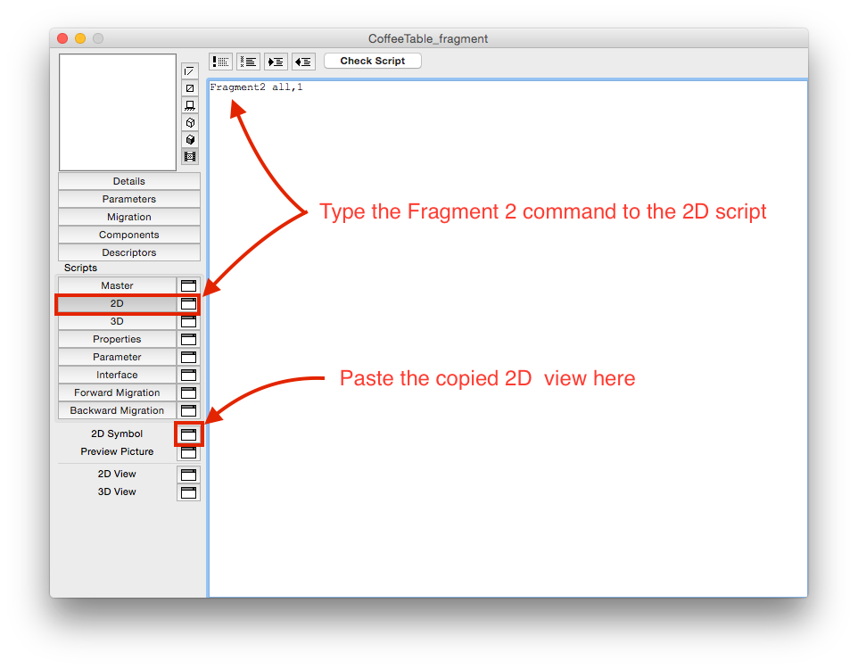

  • The update/regenerate of some objects can be slow in Floor Plan view. This happens because the 2D view of objects imported from Rhino are actually projected views (the GDL parameters use project2 command in the 2S script). To reduce the slowness Open the GDL editor, delete the 2D script of the GDL object and write 'fragment2 all,1' and create a 2D symbol from a top view.

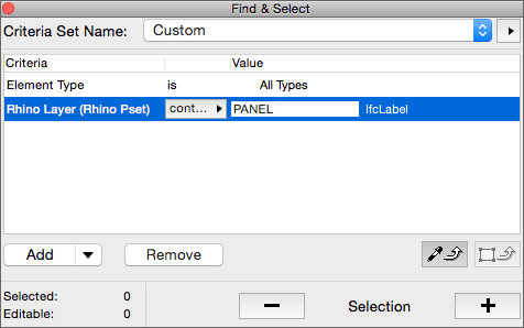

Can I filter my Rhino elements in ARCHICAD?

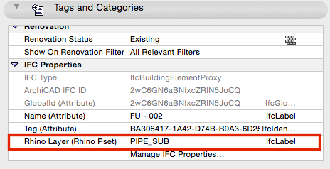

Yes, you can search Rhino imported library parts with the Find&Select tool of ARCHICAD. We added a plus entry to these elements imported from Rhino in the  Tags&Categories - IFC properties tab of objects - the 'Rhino Layer' property. These properties can be used by ARCHICAD's Find&Select tool.
In the Find&Select tool you have to add an IFC Property to the criteria (Select the Rhino Layer in the dialog). If this criteria is added you can search objects by their Rhino Layer name and can modify these objects together (eg. you can edit the texture override of multiple elemens with just one click).
