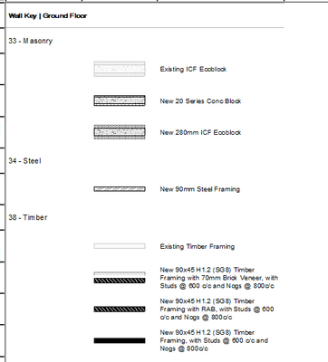

As you can image in a schedule, seeing the 4th level of the classification would be too much, where as level 1 or level 2 would be clearer.
At the moment I have an expression that returns the first character of the classification number (for the examples above that would be 3 and 7).
Then an IFS expression that marries up that 1st digit with the 8 (level 1) classification numbers above, (screenshot attached).
The problem is, to go any further would require huge expressions with IFS entries.
Can anyone suggest another method?

I've come up with a little workaround that involves expressions but no python.
Involves a Project Info Field which contains the data for each branch.
For example
11 - Contract conditions|
12 - General requirements|
21 - Demolition|
22 - Preparation and groundwork|
23 - Foundations|
24 - Minor demolition and alterations|
31 - Concrete|
32 - Earth|
33 - Masonry|
34 - Steel|
35 - Stainless steel|
36 - Aluminium|
37 - Other metals|
38 - Timber|
39 - Plastics|
41 - Tanking and pre-cladding|
42 - Wall cladding|
43 - Roofing and decking|
Then a series of expressions, using FIND, MID, SPLITLEFT.
A property extracts the first two digits from the elements classification, then compares against the Project Info, returning the text position, then displays a set number of characters from that position (say 30), then splits from the "|" character to the left.
Hope that makes sense, can do a screen recording sometime.
Does involve the manual step at the template stage of adding the level two info to the Project Info, but seems to work well from there.
