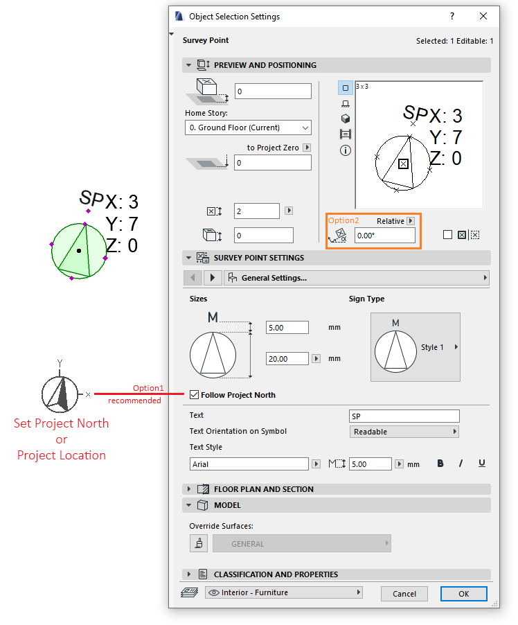

It is recommended to use a common anchor/reference point (so-called "Survey Point") to facilitate coordination of models from different programs like Revit or Tekla Structures (e.g. when connecting models submitted by different professionals). In some countries, use of a particular reference point (national datum) is a standard requirement when defining the project. ARCHICAD supports the Survey Point definition and its export and import with IFC models.
Revit example for the Survey Point and for the Project Base Point
To define this reference point, use the Survey Point Object in ARCHICAD: The position and rotation of the Survey Point define the global coordinate system (X=0, Y=0, Z=0) of the IFC model. The new global x coordinate will be perpendicular to the Survey Point`s North direction.
When defining this point position, it is recommended to consider the True North direction (use the default “Follow Project North” parameter). At IFC export, this parameter defines the direction of the Y axis in the global coordinate system.
NOTES: In ARCHICAD, True North is defined by Project North (Options > Project Preferences > Project Location). If the Survey Point doesn’t follow the Project North, then the object`s Rotation Angle will define the new North Direction.
