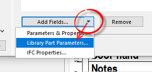

how do you schedule door handles? ..thanks

I assume the handles are part of the door objects (otherwise you would just schedule the handle objects).
If that is so then you schedule the doors, and in the field settings, you need to use the parameter for the door handles.
You do this to find the parameter ...
Then browse for the library part (door object) and find the parameter you want.
