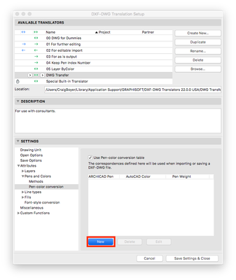

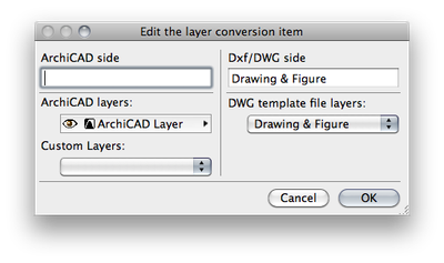

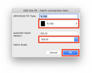

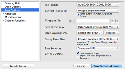

Follow the steps below to map line types in ArchiCAD to those in a DXF/DWG file. For an overview on DXF/DWG translators, click here. 1. Select the translator you wish to edit. 2. In the Settings tab, navigate to the Save Options and make sure that a DXF/DWG template file is ...

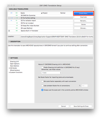

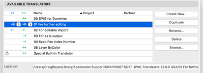

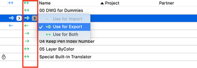

Overview of DXF/DWG Translators DXF/DWG translators allow ARCHICAD users apply a set of conversion rules to content being imported and exported from the program. Multiple translators can be setup to handle content from multiple consultants. To access the DXF/DWG translators ...

The easiest way to map attributes in a custom DXF-DWG translator is to use an existing DXF-DWG file as a template. Follow the steps below to open a DXF-DWG template file. 1. Select the translator you wish to edit. 2. In the Settings tab, navigate to the Save Options and clic...

Available: File > File Special > DXF-DWG Translation Setup By clicking on a Translator during export, you can see and edit its content in the fields below, which falls into six main groups: Drawing Units Value of 1 DXF/DWG Drawing Unit in Archicad: As you export or import so...

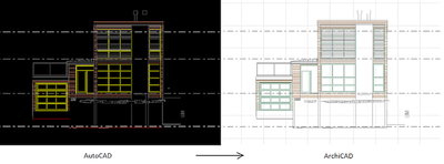

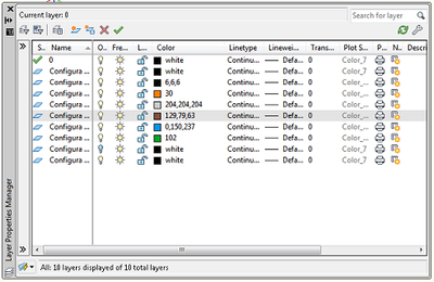

AutoCAD offers two methods of setting the color of drawing elements: ByLayer or ByBlock. In ARCHICAD you can use your default or template pen colors, if you match the AutoCAD and ARCHICAD colors following this workflow: Demo file: Ross Street House, Madison, Wisconsin, Richa...

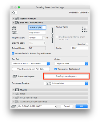

Sometimes we get reference files such as site plans, drafting aids, plans from co-workers in DWG format that we should not modify. To display two different views concurrently in any ARCHICAD model or layout window, we can use the Trace Reference feature as a temporary editin...

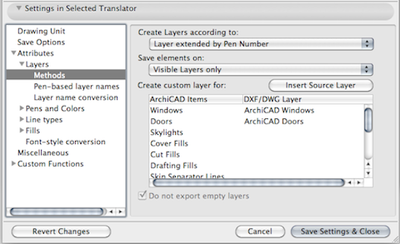

Use this dialog box to define how elements in ARCHICAD will be interpreted when exported as DXF/DWG files, and vice versa: how the elements in DXF/DWG files will be interpreted when imported into ARCHICAD. Because of the difference between AutoCAD and ARCHICAD it is essentia...

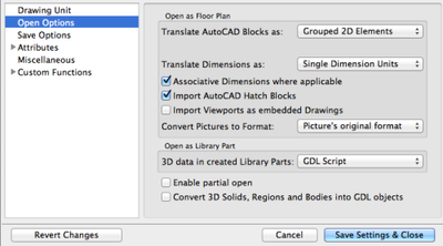

File/File Special/DXF-DWG Translation Setup By clicking on a Translator during import, you can see and edit its content in the fields below, which falls into five main groups: DXF-DWG Translator Settings Drawing Unit Select the correct value of 1 DXF/DWG Drawing Unit in ARCH...

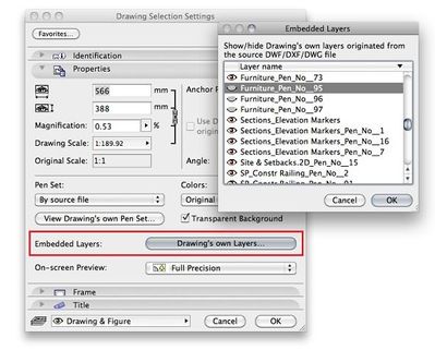

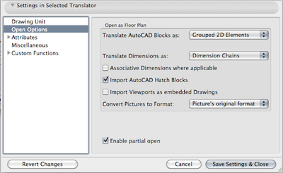

To control the visibility of objects, usually there are more Layers used in DWG projects. Let's see how can the different import options in ARCHICAD manage the DWG layers: Open File » Open To define how elements in ARCHICAD will be interpreted use the DXF/DWG Translation Set...
