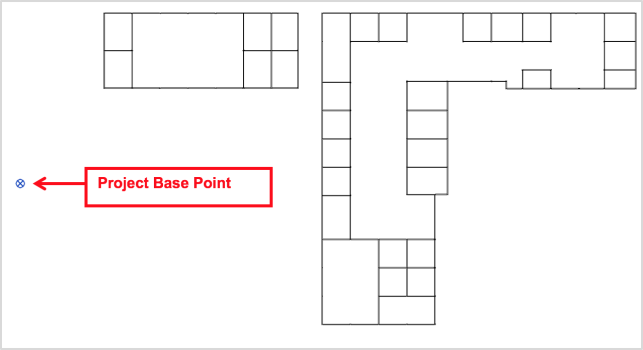

  • Create the Revit model close to the Project Base Point (indicated as a circle with a cross through it).
  • Create the Revit model orthogonally.
Tips:
  • The Project Base Point may be hidden by default. To show it at all times, press VG to open the Visibility/Graphic Overrides settings. Then navigate to the Site subheading, followed by Project Base Point. Check the box to show the Project Base Point.
  • The Project Base Point is equal to ARCHICAD’s origin (black cross – 0,0,0)
  • Do not move the Project Base Point from its start-up location, as this will cause differences in origin placement between Revit and ARCHICAD. To check if the Project Base Point has been moved from its start-up location, unclip the Project Base Point, then click “Move to Start-up Location” from the context menu.

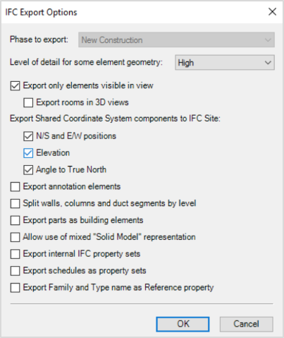

  • Export the Revit model to IFC using the GRAPHISOFT Add-In with the following options checked:
Tips:
  • The Revit model will be exported to the correct real world location as defined by the Project Base Point if you check the following options:
    • N/S and E/W positions
    • Elevation
    • Angle to True North
  • If you are viewing the Revit model in a floor plan view and you have checked the option ‘Export only elements visible in view’, only one story will be exported. Therefore, use this option only from a 3D View.
