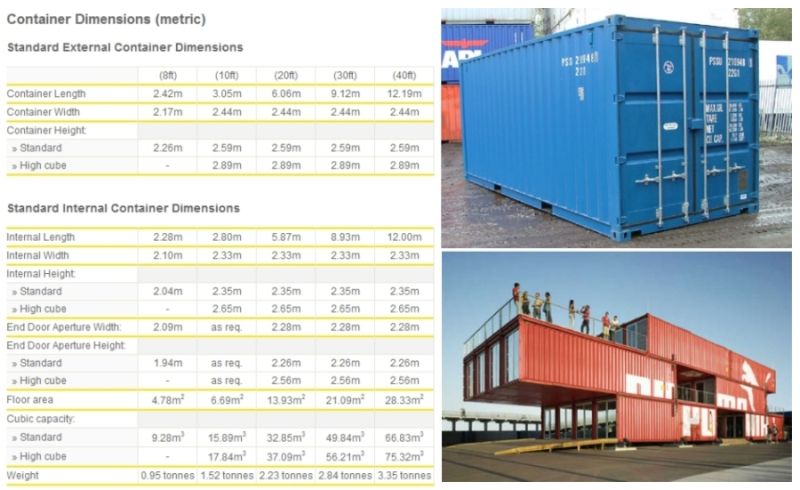

Hi Master Script,
Thank you mate!...I really appreciate your generous offer!
The thing is... I've been doing some research, and I found that there's a lot of architects making pretty good projects using it as a kind of "lego" blocks.
In the picture you can see a single container, a standard dimensions table, as well as a small example of what can be done with this amazing modular structure.
So... IMO, the object would have this parameters:
01. Length standard dimension (2d/3d editable hotspots);
02. Angle Doors opening (2d/3d editable hotspots);
03. On/off Doors (2d/3d editable hotspots);
04. On/off Right wall (2d/3d editable hotspots);
05. On/off Left wall (2d/3d editable hotspots);
06. On/off Rear wall (2d/3d editable hotspots);
07. On/off Roof (2d/3d editable hotspots);
08. On/off Floor (2d/3d editable hotspots);
09. On/off Hardware, namely door pivots and lock;
09. Material Doors (Interior/Exterior);
10. Material Right wall (Interior/Exterior);
11. Material Left wall (Interior/Exterior);
12. Material Rear wall (Interior/Exterior);
13. Material Roof (Interior/Exterior);
14. Material Floor (Interior/Exterior);
Regarding the level of detail:
- It doesn't need to represent bold and screws, just the main geometry;
- It would be viewed in 3d/2d/Sections as well in schedules;
- It have to represent all the structural columns and beams;
- Edges may all be sharp;
- The corrugated sheet may appear only in small scales;
- Beams and columns may be hollowed only in small scales;
It also would be:
- A single object with no macros;
- Scale sensitive;
- FPCP (Floor Plan Cut Plan) sensitive;
- Imperial/Metric sensitive;
Ok... I guess its a good start.
Once again, thank you for your great offer! 😉
