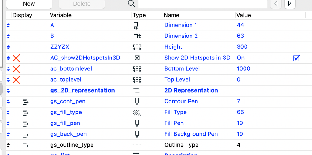

2. in Details push button Select Subtype and select the subtype from Subtype Hierarchy. When you do that open Parameters. You will find there new parameters in blue colour, they are default parameters for this subtype. They start usually with gs_ name. Explore the gs_2D_representation subgroup,  all parameters responsible for 2D are there. Important to use always those parameters in 2D script and add new 2D parameters to this sub group.

pen  gs_cont_pen
fill gs_fill_type
poly2_b (5)     5,   3,   1,   3,   gs_fill_pen,   gs_back_pen,
gs_cont_pen = outline of fill pen
gs_fill_type = fill type
= fill with outline, 2 = just fill, 1 = just outline
gs_fill_pen = hatch pen
gs_back_pen = fill background pen
number 33, in the end of numeric lines = cut line, number 1, = outline. Those lines will do differently on plan but will print as pen assign to them.
if you want to have control over the outline type than copy and paste set_line_type "solid" above pen gs_cont_pen line and change "solid" to gs_outline_type Add this new parameter to parameter list
