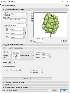

https://www.youtube.com/watch?v=b5_QGzv6RHQ&t=1493s the library / object linked in the video description will allow you to make something sort of similar.
There are some preset trees that you can change to use sphere shapes instead of warped planes, maybe lower the amount of shapes generated and change the surface material to something solid.

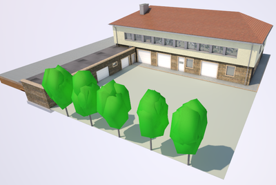

Some quick try:

Massivator trees can look nice, but they are slow... =S

Have a look at the first 'panel' in the settings. That's where the amount of leaf objects are generated. You can try cutting the numbers in half to see if the results are still good enough.
It's going to look like an abstraction of a tree regardless, so I ussually go for a bit of artistic license. Then again, I'm no botanist, so I tend to go for 'good enough' quickly 🙂

I had the same problem, so I built one 😀
It was one of the first objects I built for Archicad, and it is unfinished, but should be usable as a starting point.
I was inspired by the simple massing geometry that Google Earth uses. It ought to be possible to get a good foliage texture to map to this so it looks like a GE tree.
The 2D symbol is quite nice too, and I have some alternative options that can be used.
I can provide the actual source geometry if anyone wants to take this further.
