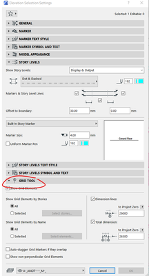

Hello,
We are having an issue with uneditable floating dimensions showing within our elevations. We cannot figure out where these dimensions are coming from or have been made. They are showing on several different layers but can never be found elsewhere in the project.
They act as if they are locked, however unlocking them does not do anything. We can click on the text, delete the text and string, however when we go to the sheet layout they are still present and when we go back into the view, they reappear.
Wondering if anyone else has had this issue and had any luck fixing it.
Thanks!

have you tried checking the elevation settings?
then you can disable the dimensions here.
