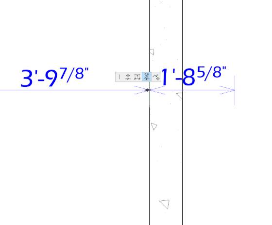

Our company recently upgraded to 25 over the past month and we have just realized that any dimension, usually under 8" looses it's arrowheads. We have seen others talk about it, with the work around being to make it a separate dimension string or to even make the arrow heads smaller. The dimensions look normal in floor plan but they disappear on sheets. Has anyone else found a better way then to change it to a single dimension string or changing arrowhead sizes? Most of our dimensions are in Mods and it would take months to change them all and changing the arrowhead size is out of the question.
Does anyone know if this bug will be fixed soon?

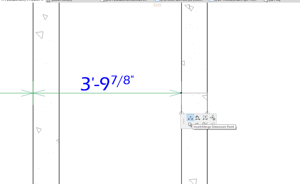

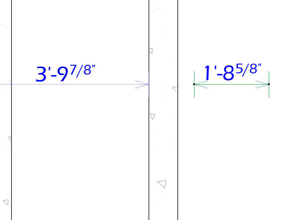

2022-08-24 02:54 PM
I've attached a few quick screenshots to reference for this. When you start with a single dimension, you have the choice when you click on the line of the dimension and it will bring up your pet palette with the option ( see image 1) to insert/ merge dimension point. It will then allow you to continue the first dimension, this is a good technique for doing lots of dimensions in a row.
When I say single dimension string, there is an option to then break the continuous string of dimensions (see image 3) with the scissor tool. Click to the right or left (see image 4) and you will see that only one dimension is still highlighted. (see image 5) These two dimensions are now no longer continuous, both are a single dimension string.
I hope this helps, I don't have much experience in teaching people how to use the program yet.
