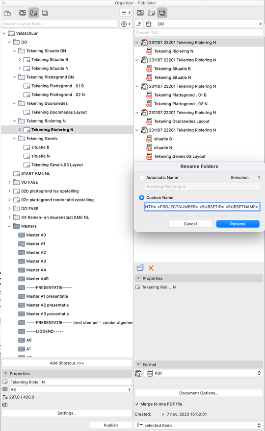

I am experiencing the following problem and I am wondering if I am doing something wrong or something else is up.
When renaming folders (created by "Add shortcut") in the publisher set (merged into a single pdf) which uses the autotexts <SUBSETID> and <SUBSETNAME> the actual subset ID's and subset names are changed to the subset ID and subset name of whatever layout isactive as a tab/window.

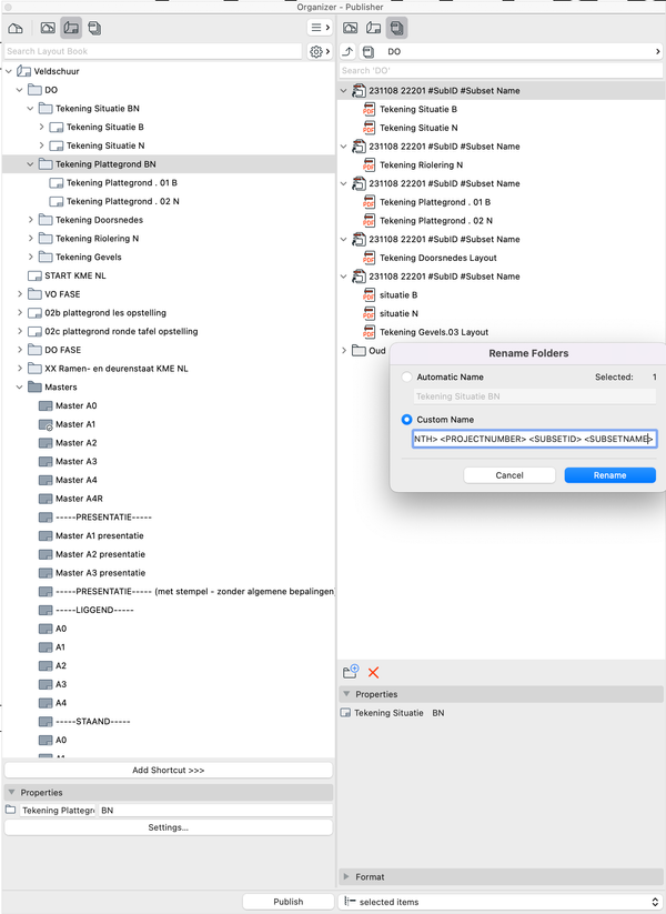

Closing the tab with the layout results in a folder name where the autotext is only displaying #SUBSETID and #SUBSETNAME.

Only workaround I have found is:

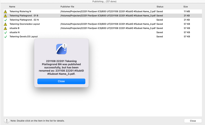

- renaming and publishing each folder one by one with a layout active from the corresponding subset with the file to be published in first place in the publisher set or else. Not doing so gets the file renamed after publishing to the active layout or to #SUBSETID and #SUBSETNAME when the layout tab is closed.

That button also eluded me the first time as well. Our local service agent just notified me that this is indeed a bug, filed under: DEF-16976. Hopefully this will be fixed in the near future.
