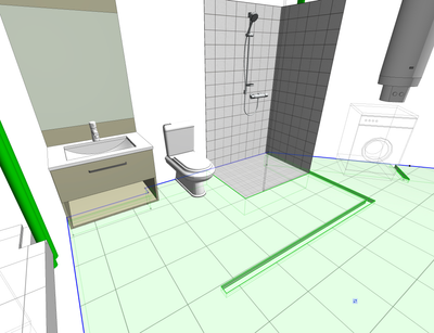

Just curious if Archicad 25 would finally have this long needed feature? Automatic alignment of 3D texture to 2D fill of that same surface material? I know we can align in 3D window but it's such an unnecessary work. There's gotta be a way to automate this

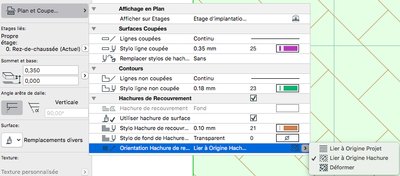

Like this for a long time 😏

This is only setting the 2D fill in the plan, it doesn't affect the 3D texture.

Try the texture follow the orientation

You misunderstood my original post. The problem is: setting the 2D fill origin doesn't affect the 3D texture origin.

I just read on the Archi-cadlink forum that this function has disappeared since Archicad 23.
The managers of graphisoft may be able to explain to us how an essential function was removed 😡

It's been two years and two versions since this bug was introduced.
Graphisoft are you listening?
https://community.graphisoft.com/t5/Design-forum/BUG-in-23-Slab-and-Roof-Surface-Textures-in-3D-do-n...
AC user since 8.1
@GRAPHISOFT  any news regarding this bug? Crazy that such a basic thing is not working properly... especially since it has been working before...
