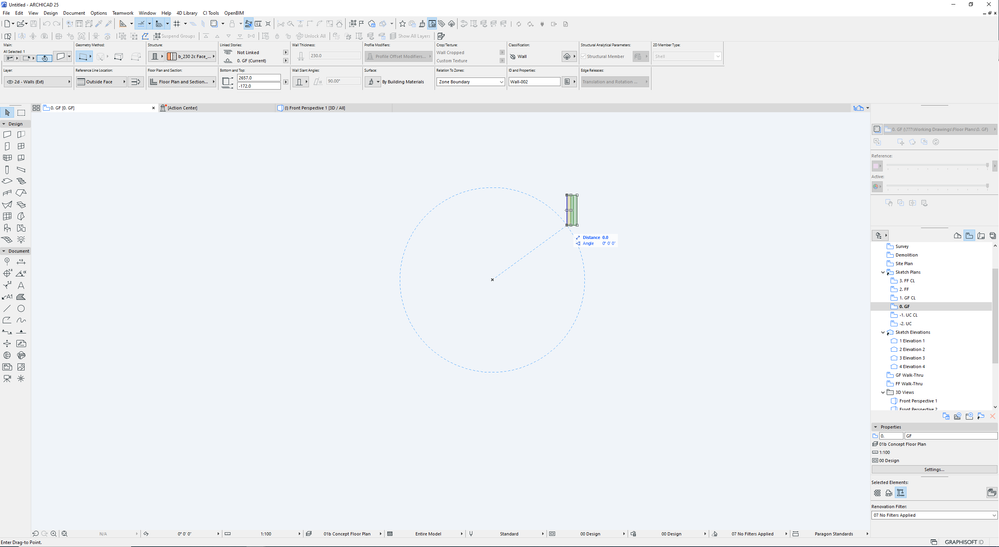

When I go to move any object around, I keep getting a circular guideline appear from the drawing origin point and it's annoying me. I haven't always had it, so can only assume I've accidentally turned it on some how?

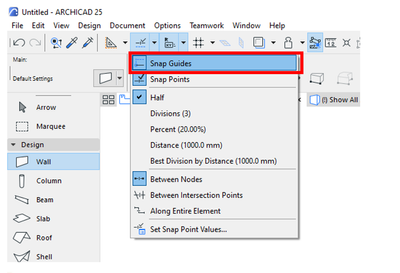

If I turn off Snap Guides the issue resolves, but then I lose all the other snap guides as well.
AC27 Build 5060 AUS - Windows 10 Pro, Ryzen 7 5800X, RTX 3090, M.2 NVME 0.5TB SSD, 32GB RAM
AllanP
those are snap guides.
if you leave your mouse over a point for more than 2 seconds, it gives you a temporary measurement point and those lines/circles from any other temporary measurement point.

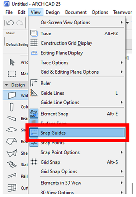

to turn them off you can select the snap guide icon
or
go to the view menu

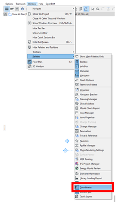

The Coordinates are located in the  coordinate pallet
i hope that helps

@Liamthanks wrote:
What toolbar are these options located in?
It is a 'Palette' rather than a toolbar.
Windows menu > Palettes > Coordinates.
Thanks Barry, turning that setting on appears to have resolved the issue and I've now updated my default work environment to suit.
