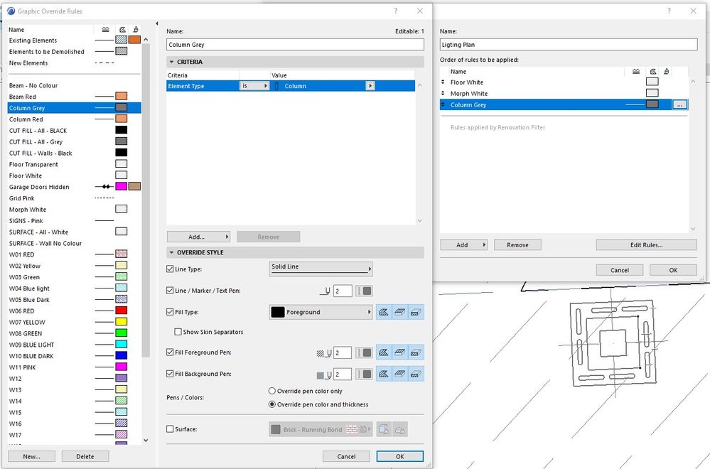

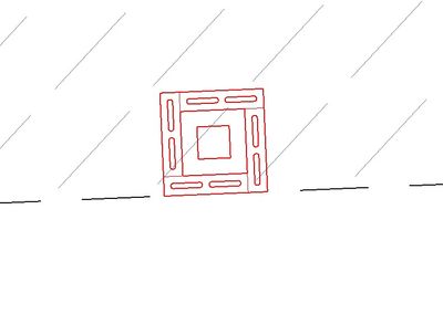

I have some columns made with the complex profile.
On certain plans I would like to display them as only a solid square, and not show the detail.
I've "trialed & errored" it for a while, and cant seem to figure it out.
Any help would be appreciated.
Below the column and the override I have at the moment.

@Johann_P The running order for the rules is reverse logic (or it used to be), so the top of the list is processed last and the bottom first šŸ™„. So if the upper two could include the column they would take priority. But from what you describe that may not be the case. I am guessing the remaining shapes are empty voids. If you apply a Fill so there are no gaps in the Complex Profile by using the standard "Air Space"  Building Material then the "skins" should disappear.

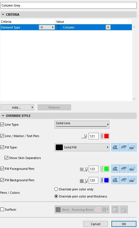

@Johann_P Try turning off Show Skin Separators and you should be left with just the outline. Also check that no other GO rules are changing the same columns if you have more than one applied.
Johann_P
Thanks @DGSketcher
I have tried that but no change.
The other 2 overrides I have are related to morphs and slabs
My current settings
Johann_P
Thanks @DGSketcher !
Solved with the additional fill.
