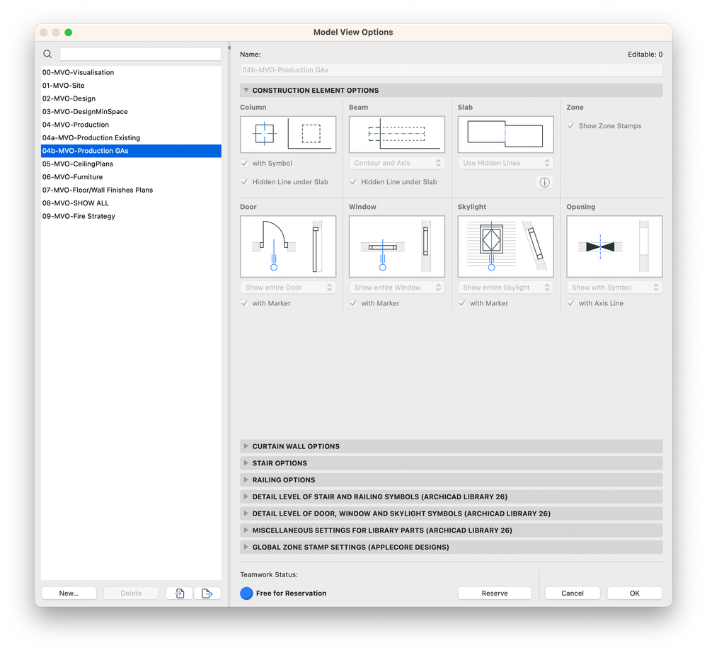

In my model I have two slabs with different materials to simulate the difference between two pavement floors. The problem is that in a plan view the coincident line between them is represented with a dashed line instead of a continuos line.
How can I fix that without creat space between them?

Lee Hankins
This can be changed in the Model View Options under Construction Elements.

Solution
Lee Hankins

Figdor
Thank you so much! You save me
