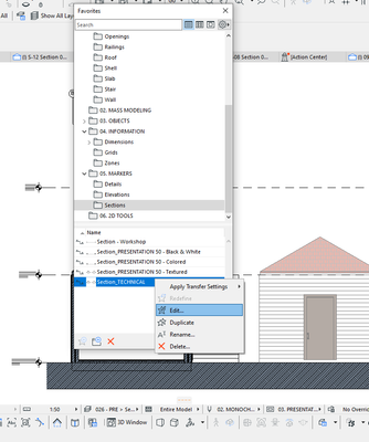

Hello,
When I try to create a favorite for the Section/Elevation settings from a selected Marker in the floor view, Archicad only creates a Favorite for the Marker settings! How can we create a Favorite for the Section/Elevation settings??Screenshot (144).pngScreenshot (146).png

I think the section/elevation settings are still stored in the favorite, even if you seemingly can't access it via the favorite palette. But if you create a section, put your settings correct, and then create a favorite from that selected section the settings should be stored in the favorite.
