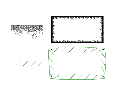

Does anybody know how to create a custom, asymmetrical line? I.E., when I draw the line, I want the symbol to be justified to one side and not centered on the custom symbol created. There is a stone symbol in Archicad which does this, but I cannot find a way to replicate the phenomenon. See attached images which show how the symbol relates to the drawn rectangle. The new one I'm trying to create (bottom) is using the center point of the symbol I drew as the reference line while the stone symbol (top) uses the top horizontal axis of the symbol as the reference line.

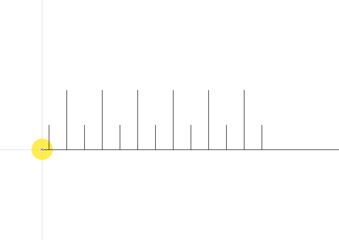

The Project Origin have to located within the bounding box of the copied elements, then it will be used for alignment.

Something like this ( Project Origin Highlighted yellow )

@EH21 Do you mean like this?

Thanks for the input...Andrii's response seemed to solve the problem
