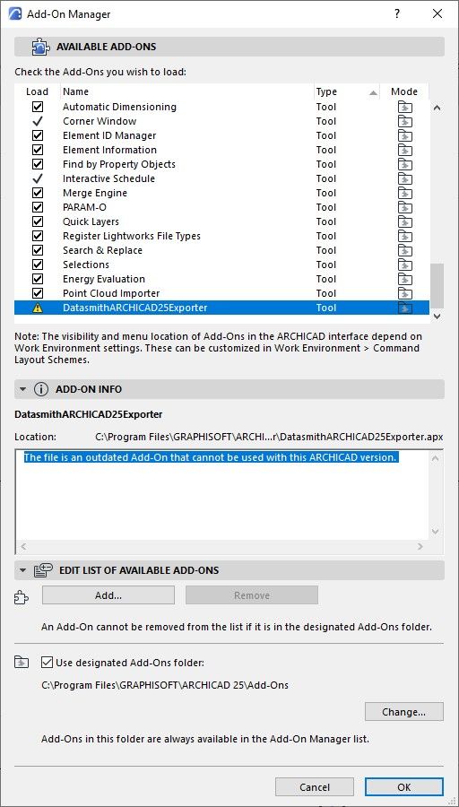

I recently installed the Datasmith Plugin from the Unreal Engine Webpage, as directed at the Graphisoft website, for Archicad 24 & 25. According to the procedure there should be a Datasmith Palette under the Windows > Palettes . However, for some reason there isn't. I even checked in Add-On Manager, there it shows an entry of Datasmith installed correctly but with a message that, "The file is an outdated Add-On that cannot be used with this Archicad version."
Surprisingly, My Archicad 24 & 25 are up to date, so is my Twinmotion and Datasmith Plugin. If anyone knows how this issue can be resolved please guide me towards it. I have attached a screenshot for reference.Datasmith Issues.jpg.

Do you have the latest build of Archicad 25?
As in build 4013?
Maybe that is the problem.
I believe this is acting as a completely new version of Archicad.
Build 4013 can open older build 25 files, but the old builds of 25 can not open the new build files - just like version 24 can not open version 25 files.
Therefore the Datasmith add-on may need to be re-compiled to suit the latest build of 25 - just like it had to be re-compiled when we changed from 24 to 25.
Effectively we have changed versions from 25.1 to 25.2
I might be wrong, but that is my hunch.

There is no Datasmith palette for AC25 as in the previous versions.
You have to save the project as a Datasmith file type then import it into Twinmotion.
hope that helps.

Hi Sedley,
Thanks a lot for the response. Interestingly, I saw a video on YouTube uploaded by Twinmotion (link attached below) that shows how the datasmith palette is supposed to work. However I suppose I might have to wait for another plugin update.

I really appreciate your response. I also suspect the same thing but for me what's confusing me is the fact that when I install the plugin it gets installed for Archicad 24 that I also own but the plugin doesn't seem to work for 24 even.

Hello,
Thank you very much for the question!
Unfortunately, the addon is developed entirely by Epic Games. We tested the addon here and did not encounter any similar problems. If reinstallation doesn't help, I suggest reaching out directly to Twinmotion support for further investigation.

Hello Minh, thanks for the response. I have a question though. Is it possible that the new datasmith plugin is not usable for the people who have a monthly subscription of Archicad ?
However I reinstalled the latest versions of both Archicad 25 and Datasmith plugin but still the same is issue. I hope this gets resolved soon.

As far as I know, the addon itself does not consider the license type you are using. But this can be answered by the Twinmotion support better.
I'm wondering if you have contacted them about your issue yet?

Yes, I have dropped a report as directed by the Twinmotion support system but have not received anything from their side as yet. I believe if this issue does not gets sorted out soon I might have to either switch to Revit or vectorworks and try datasmith there or maybe switch to Lumion.
