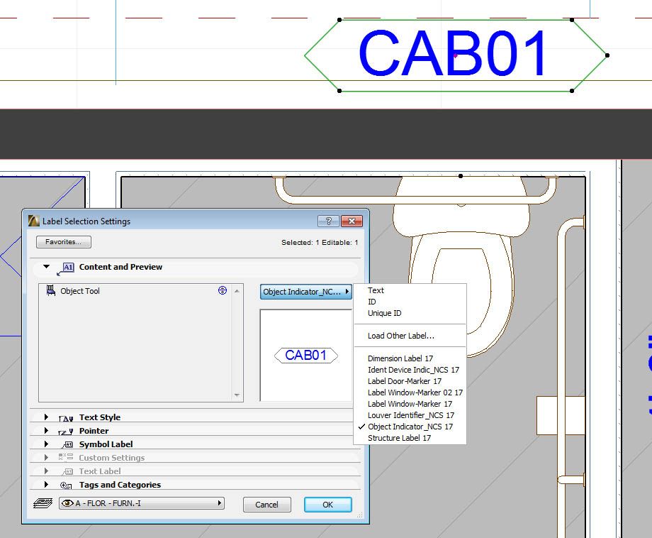

How can I change the default layer for labels?
I would like the labels to automatically show up on the same layer as the objects they are attached to.
3 REPLIES 3
Right click on the label and you get the label selection settings.
As far as making the default follow the layer of the objects.
The short answer is to use favorites to save the settings for your common objects.
For true associative layer naming - that gets into GDL territory - as there is only one label for all objects - regardless of whether you are referring to a toilet or an emergency exit sign, etc. BTW, I really like putting labels on a separate "Label" layer, such as an annotation layer, that way I can show a presentation plan without labels, or a CD with.
You might also search the forum for advice on creating custom labels.
