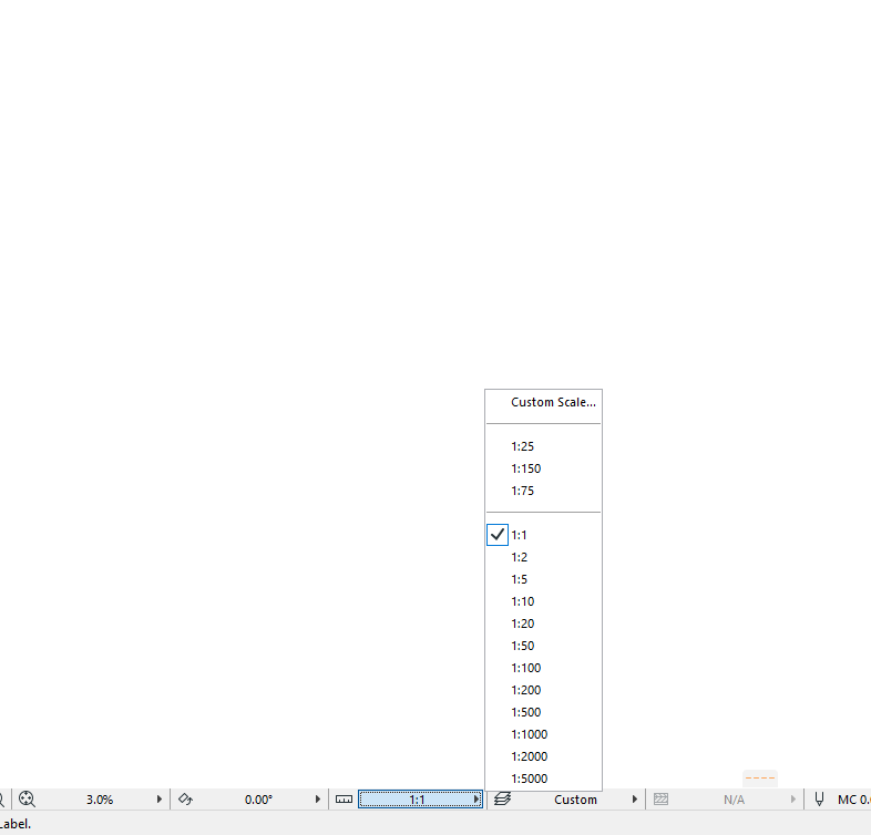

Hi All,
I have imported, as xref, a DWG file, and I set in a worksheet document.
I need to manipulate the file and I noticed that all the dimensions are not scalable. I mean they remain as they would be in a paper space and not in the model.
The consequence is that when I re-scale the drawings all the figures of the dimensions are enormous, instead all the text are re-sized.
Is there any way that I fix this matter? Or Do I need to delete the dimensions and re-make them in the view map?
Many thanks in advance
Regards
Mariano

Try the view scale, this is likely to be the issue šŸ™‚ Go to the bottom of the view screen, and 4th tab from the left in is the scale - alter this to select a scale that works for your view and the text/dimensions should scale accordingly, hope this helps. Screenshot 2021-09-03 060406.png

I tried already this solution, unfortunately no all the texts seem to re-scale accordingly.
Thanks anyway much appreciate.

Solution
DGSketcher
Legend
If you need to access & edit the model space part of the DWG then you may want to consider using the merge option which is possibly more suited to your immediate needs...
Merge DWG
You can merge into a new/separate PLN file and if necessary Hotlink that into your main project file.
