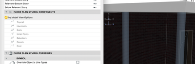

I have a similar issue - but with Railings.
I have created a new MVO and set the detail level to be full. It's always railings.
In fact railings always create problems for me in AC25.
Seems to be just a Mac-specific thing. It's a chronic problem because restarting AC doesn't fix it.

2023-05-19 10:48 AM
Yes - I've checked everything. Changing MVOs doesn't seem to change the display, so I think it's a file-glitch. The file originated from a template from AC25, so I suspect there might be some random weirdness introduced.
I do get these from time to time, and they don't manifest on colleagues' Windows machines.
Weird.
I've cut and pasted the geometry into a new file (MVOs and GOs are almost never modified) and it's working fine now.
There are so many little settings and subtleties in Archicad that it's easy to miss stuff. I also checked the renovation filters.
