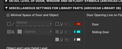

Attached is a screenshot of a door with the clearance allowance with a solid hatch fill. I tried a few options to cancel the solid fill in vain. Any suggestions?

Check the MVO space settings...
