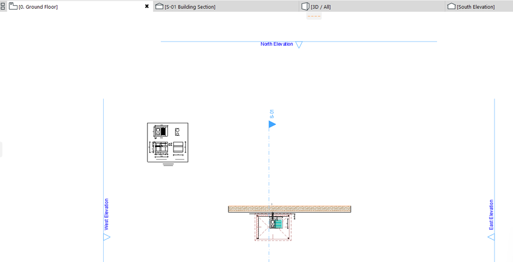

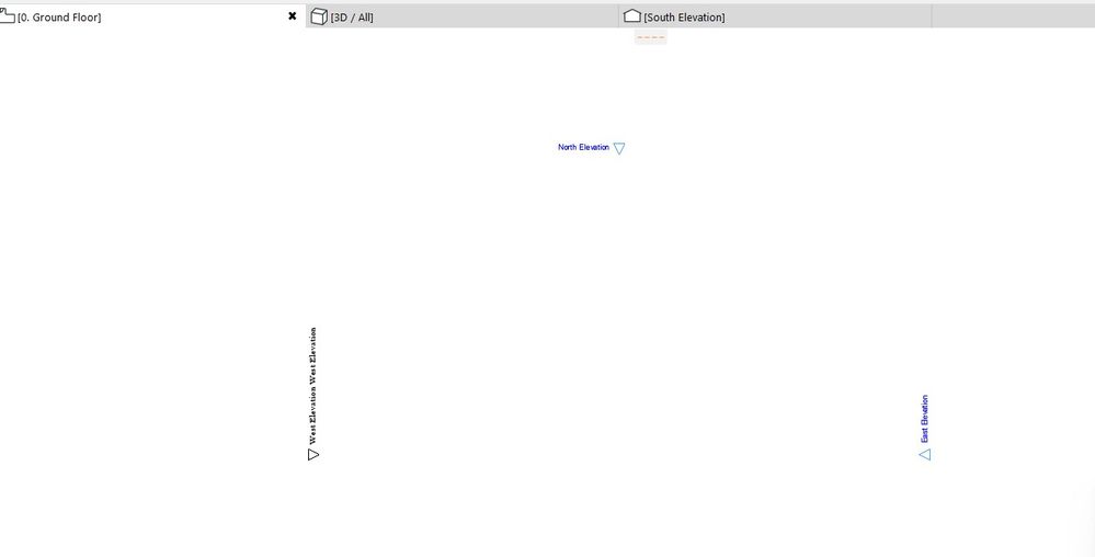

How can I be able to see the elevation lines in my floor plan view ,and how do I also get to edit its line weight ,
I have attached an image of my elevation lines showing and when they are not showing I cant find out why they are not showing
elevation lines are showing here
elevation lines are not showing here

2023-08-27 01:33 PM
Go to View > On-Screen Options > Marker Range
Go to Work Environment > User Preference Schemes > On-Screen Options > Line Type and Pen of Marker Elements' on-screen-only parts
