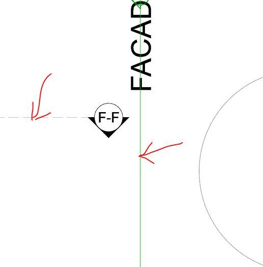

Trying to find the setting to turn on the line between the marker heads.
I have turned it off or changed the colour, but cannot find the setting that controls this in the info box.

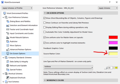

Aaah, sorry, I understand now. I don't think you can have this line (for output) in between both marker heads with the built-in elevation marker.
However you can control the "virtual" visibility of this marker line through View > On-Screen View Options.
You can also adjust this color in the Work Environment UI:

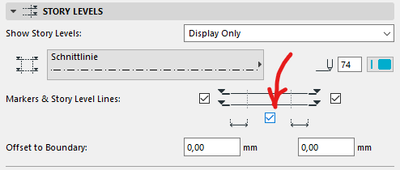

Miha_M
Section Selection Setting > Story Levels
and
...if you need to have these lines in your published docs.

Hi thanks you. I  am however refering to the marker lines on plan view, between the marker heads
Thanks

Sorry, the thread title mentions elevation. Which elevation marker lines on plan view, could you make a screenshot of this marker head?

Sorry, I ment the elevation marker on plan view, which I want to show the line of the elevation across the plan, similar to the section marker.
