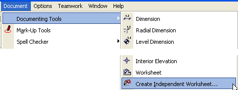

1- Create an Independent Worksheet using the Document > Documenting Tools > Create Independent Worksheet command.

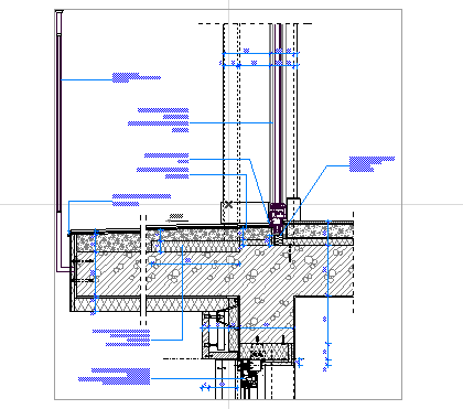

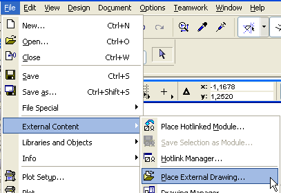

4- Use the File > External Content > Place External Drawing command to place a Drawing containing the standard detail drawing into the Worksheet View. There are several file types you can choose from, including ARCHICAD Project File types, DXF/DWG files, DWF files and PDF files.

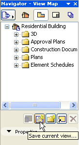

6- While still in the Worksheet, switch to View Map in the Navigator, and click the Save Current View button. (If you want it in a specific location in your View Map, you will need to place the Saved View into a folder in your Organizer later)

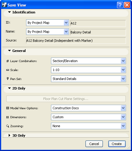

7- In the appearing dialog box, set all fields to their desired values and click the Create button to create the View according to these settings.

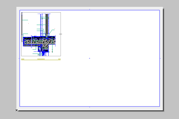

9- Switch to the Layout and move the Drawing created from the Worksheet View to the position of your choice.

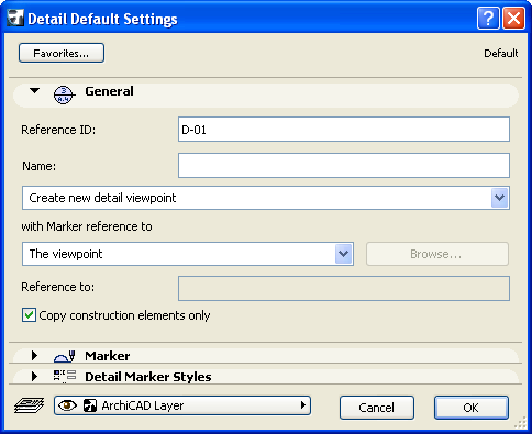

11- Activate the Detail Tool and go to the Detail Settings dialog box.

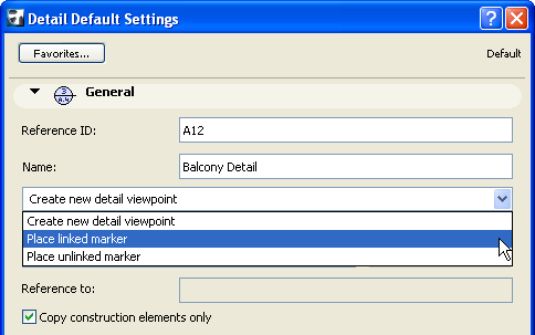

12- Set the Reference ID and Name for the Detail Marker. Under the Name field, select Place linked marker from the drop-down list.

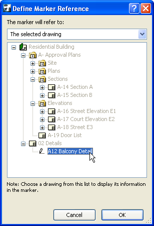

13- In the appearing Dialog, select The selected drawing from the drop-down choices under “The marker will refer to” field. In the field below, the list of Layouts appears. Select the Drawing created from the Worksheet that contains the standard detail. Click OK to accept your choice.

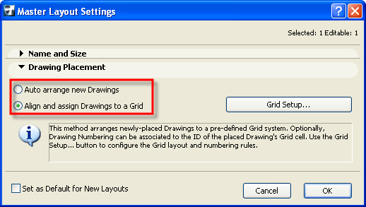

When you place several standard details into your Project, it is a good idea to first place them all into Worksheets, create saved Views for all of them, and then drag-and-drop them onto Layouts in batches. In Master Layout Settings, use the Drawing Placement panel to define how the program should arrange a batch of Views dropped onto Layouts. This way, you will not have to place each Worksheet View individually on Layouts.
