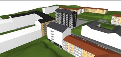

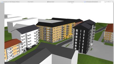

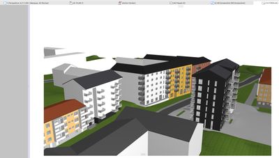

Hi I would like to reach good 3D view what I can present for design alternatives.
- I don't need rendering and Archicad rendering view is so time consuming 😕
- I'm doing silly but working solution. I preset 3D view and than I do Screenshot
=> Look much better than 3D view But but When I move something I need to do new screen shot and again and again.
I'm doing this solution for few years and I getting be tired of it.
● Do you have some tips how to get nice 3D view which is still updating with any changes ?
Example of 3D view
- Screenshot from Perspektiv 3D view

2022-05-17 09:28 AM
Nice 👍 I this is what I looked for.
Solution from video :

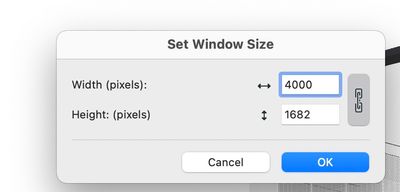

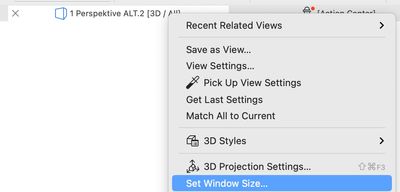

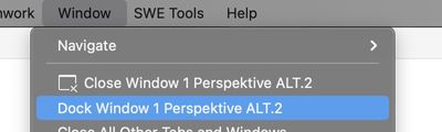

● Right click on tab of perspektiv and Set Windows Size for bigger example ( 4000x 1682 ) Lock the proportion before
● Save 3D view
After :
● Click to - Window - Dock window Perpektiv
- I wish have just option in setting for 3D view for saving and not doing this 3-5 steps for every other perspektiv. 🤔

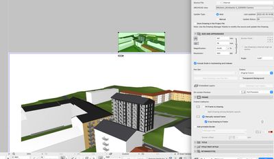

What I do is place a Camera for the 3D view, this Camera appears in the Project Map. It can then be moved to the View Map. When you have your 3D Settings as you wish, select the Camera in the View Map, open its settings and click the "Get Current Window's Settings" button to capture the settings of the 3D view. This View can now be added to a Layout for presentation. Once on a Layout, this Drawing can be selected and you can use its settings for either Auto or Manual Update.

Can I sett better resolution from camera view ?
Or what is the advanced use camera for getting nicer 3D view ?
My biggest complain with 3D view is how it look on drawing because you cannot sett resolution or you can do it but the size be change too.
For exapel there is preset for 72 DPI and I woud like to get with 300 DPI with bigger size ( resolution )
Here is how noSharp is view on drawings 😕
