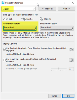

I am assuming the foundation slabs are in a storey below you main floor?
If so you can try this.
Set the slabs to show on 'Home Storey & One Storey Up'.
Then in Project Preferences > Legacy you can set your slabs to use a dashed line when shown on storey above.

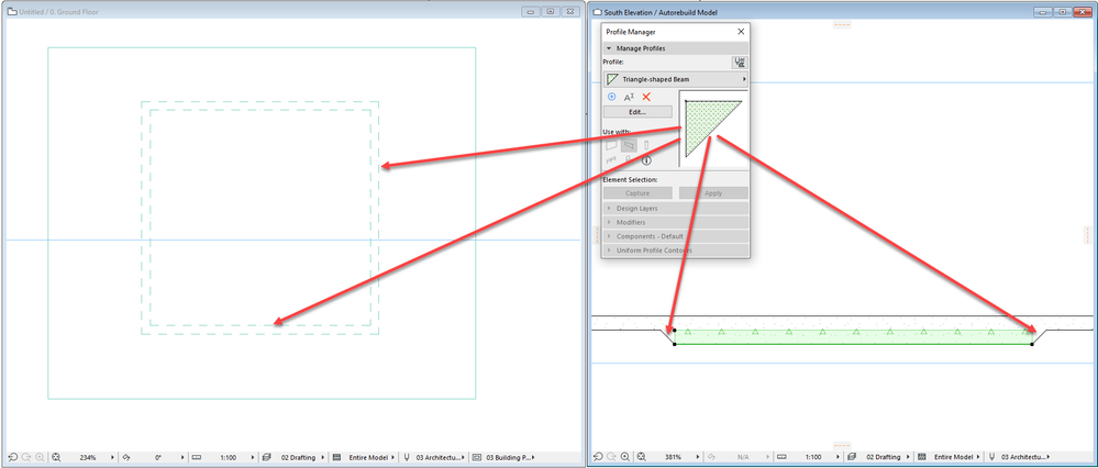

You could model the sloped bottom Slab using multiple elements. The idea is to model separately the parts you want to display using a different linetype.
In the attached screenshot, I have used a 150 mm thick Slab, then placed another 150 mm thick Slab below it, and set its outline to a dashed linetype.
Then I created a Triangle-shaped Profile and used the Beam tool to model the transitions on the four sides and I also used a dashed line for its outlines. This gave me te desired Floor Plan representation.

A beam around the edge of the lower slab is a great idea, as the beam will automatically show as hidden (depending on the Model View Option Settings).
The down side is the beams are not associated to the slab, so if you have to edit the slab size/shape, you have to edit the beams as well - that is not hard.
