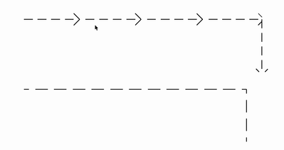

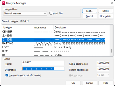

I am trying to import this Linetype from CAD to Archicad. What should I do?
LeeJaeYoung
1. I want to import in paper size.
2. Is it possible? I just come in like this.
AC27 on window 11

I don’t think there is a way to tell the line type to finish and start with a dash unfortunately.

You need to convert the text to lines too.

Sorry. I’ll try and explain a bit better. Line types don’t recognise text or letters. You need to trace over the letter with lines and arcs so that the letters become 2D linework too.

is this the best?
The finish was not processed like the bottom part.
Can you make the beginning and end part handle well?
Actually what I want is to ask because I need now to end with a line with no arrows at the start and end points.

No, not when it is a 'symbol' line type.
The 'dashed' line types automatically show a solid portion at the start and ends.
