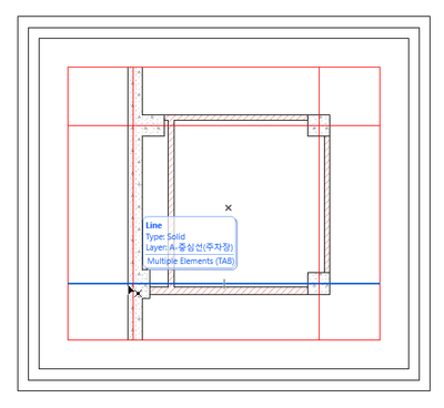

I'm startled right now
I'm hoping you'll tell me I'm wrong.
I am preparing a partial drawing, but the lines and dimensions are not linked.
1. In the detail drawing, if the drawing is modified and then rebuilt, it is changed to a non-interlocking stupid dimension or deleted.
I'm hoping you'll tell me you're wrong.
This function is also available for partial drawings created by AutoCAD importing xref files.
2. In order to interlock, you should not put a dimension line in the center line by covering it with a fill in the plan view and making a hole. Talk about finding the end line.
All drawings are 1/500 scale. The partial floor plan is 1/100.
I have to go to the dimension at the end to put in the dimension.
And this method should not be used.
I want you to tell me how to draw a partial plan with interlocking dimensions.
The floor plan is only in the inner rectangle and has dimensions in the rest.

For partial plans at the same or different scales, I do not use worksheets, simply because they are not 'live' views.
I use extra layers for the annotation and layer combinations that can isolate a plan view without annotation and one that shows just the annotation.
You can then place these views on a layout, overlaying them on top of each other.
Crop the plane (walls) view to just the area you need and extend the annotation only view to show the annotation you need.

Would it be rude if I asked for some images?
It seems difficult for me to understand correctly.
This is a partial floor plan that I am trying to create.

2023-06-06 07:21 AM
Go to the link in my post.
It is simply just view over-laid in the layout and crop the frames to show the area you want.

2023-06-06 07:39 AM
I've read
Yes, I will study more.
I understand the overlapping in the layout by doing it myself.
The problem is how to do the dimensions and centerline...
You didn't understand that part.
thank you ^^
It would be really helpful for me if this problem is solved.

2023-06-06 08:04 AM
Oh!
If you add one, it's a Grid bubble.
You can specify the position of the callout and each floor plan.
It seems that this is what I am uncomfortable with from using it in REVIT.
The various advantages of ArchiCAD have been learned a lot by you.

2023-06-06 08:05 AM
No I don't understand.
If you want to draw centre lines you can and you can dimension those lines if you want.
If you are talking about grid lines - I never use them.
