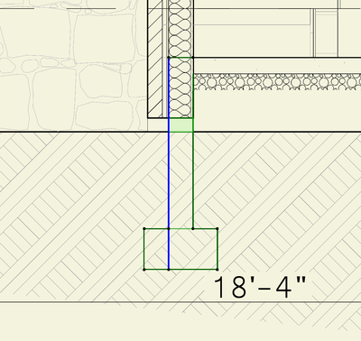

Hello, I am having issues with the wall assembly displaying correctly in relation to another wall and the site grade, modeled as a slab in the section view.   In this example, the concrete footing should be in the foreground of both the earth "slab" and the framed wall above it.   Typically, I can adjust the display order to fix this visually. The concrete wall is at the highest display order and the ground is the lowest.  Also, the concrete material priority is higher than any of the other materials in this scene.  The different layers have the same Intersection Group Number of 1.   I adjusted the junction order of the concrete wall from 8 to 1 and for a moment it looked correct and then I changed views and came back to it and it no longer worked.  The upper wall has a junction order of 8.  There aren't any solid element operations happening.   Also, I'm using archicad 26.  I'm at a loss for what other toggles I can work adjust to make this look right.
It also seems that the concrete wall is interacting with the slab and wall above it in a way that they're both cutting voids into the concrete, the opposite of what I'm aiming for here.

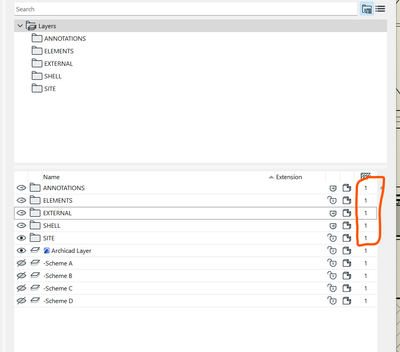

I recently transitioned to ArchiCAD 26 and reorganized all of my layers with the new folder structure.  I realized that the folders also have an Intersection Group number which was blank when I created each folder. I assigned a number to each one and that solved it.
ArchiCAD 24, 25 & 26 US
WINDOWS PC, 16GB RAM, Intel(R) Core(TM) i7-3770 CPU @ 3.40GHz 3.40 GHZ, NVIDIA GEForce GTX 970, ASUS, CM6870, Rev X.0x
That shouldn't make any difference.
That simply (temporarily) set all the layers in that folder to have the same intersection grouping number.
As soon as you select a layer combination it will reset the priority for the layers based on what was saved in the combination.
The folder will then show just a dash ( - ) if the layers in it have different numbers.
Make sure the layer combination you are using for you section have the correct layer numbers.

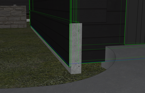

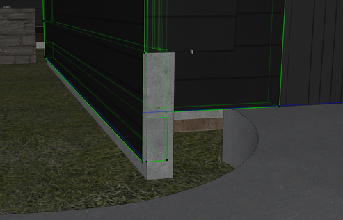

I found what was driving that wall height oddity. The wall at the corner that intersects with the framed wall shown in section had a higher base elevation and adjusting that wall height changes how it looks in section. It seems that because I also have a concrete stem wall interacting with the framed wall that it also interacts with the wall around the corner differently than if the concrete wall wasn't there at all. See images below with adjustments to this corner wall.  They only seem to "look" correct with both walls at the same height.   In this case the siding extends down past the concrete so I was trying to avoid building a different wall assembly only where the siding and concrete overlap.

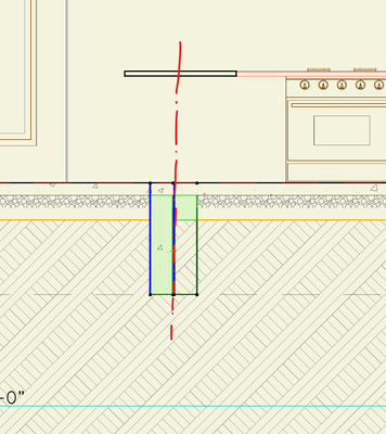

Okay, I'm continuing to have some headscratchers here. In a different project file, this foundation wall has the exact same settings, I copied the instance next to it, but at an arbitrary plane, the wall no longer cuts through the earth as I intend it to (the concrete has a higher priority, layer state, etc.) I moved the same instance of the wall incrementally and discovered this strange "line" that once crossed, no longer behaves the same way.  This same thing happens in one other section at a different plane but it's mirrored.  In the 3D model there is nothing modeled here in all the layers, renovation filters etc. Any ideas on what is going on?
