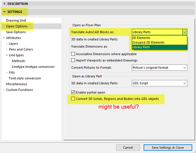

Have a look at the translator settings.
This is from 22 (all I have open at the moment), but it will be similar in other versions.

Solution
THANK YOU SO MUCH ^^
