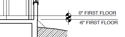

I think Erika is referring to something like this, a line or arc could be added if needed.
David

Bummer - I was thinking more like the jog a grid is capable of...

Perhaps a library part such as shown below would suffice? While this is not a Story Marker that will appear automatically, it does work well when needed.
Erich
