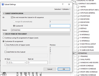

You can tell each subset to start at 1 again
that is the solution we use for contract and estimating sets.
Sub sets are your friend...

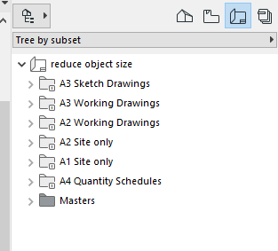

You can only have one layout book per file, but you can create as many layout subsets as you need.
Each subset can contain the same or different views to each other.
For example I have 'Sketch drawing' set that use views showing a simplistic sketch plan and elevations with reduced annotation layers.
And then I have a 'Working drawing' set that uses views for construction documentation.
I then have publisher sets for each and publish what I want when I want it.

Solution
I have been using ArchiCAD continually since ArchiCAD 4.5, 4.5.5, 5, 5.1, 6, 6.5, 7, 8, 8.1, 9, 10, 11, 12, 13, 15, 18, 21, 22, 25, now testing 28
Member of Architalk since 2003, but missed the migration to Graphisoft. Melbourne, Australia
Also if you want auto text to say page 1 of 15 for the sub set 1 or page 1 of 7 for subset 2,
you have to a different master for each subset so you can have auto text for total number of layouts in that subset.
Insert autotext -> Number of layouts in subset -> Subset name
they have made it easier since Archicad 20 to do this.

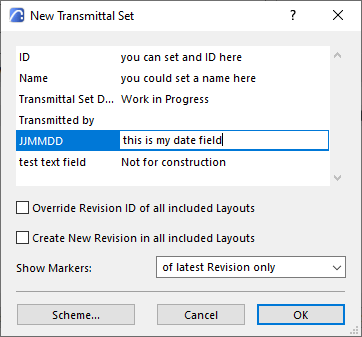

Erwin Edel
Rockstar
If you can teach them how to make a transmittal set, you could use the transmittal set scheme for an autotext field that only needs to filled out or not:
